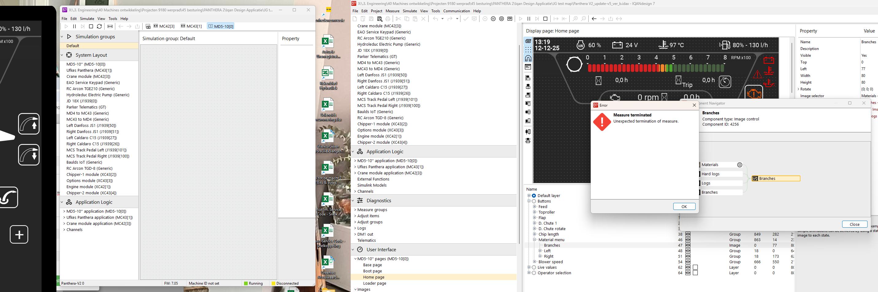

Simulate version 7.05.14.7291, in runtime, crashes the IQANdesign  7.05.27.10982 version, when I navigate in Design to Images or opposite direction. Error Message Measure terminated appears, the only way to leave IQANDesign is delete the IQAN app in the computers Task Manager

Also happens when I sometimes open a page in Design during Simulate runtime directly, sometimes when I close simulate first, Design will proceed after [OK].  Strange behaviour.

No typo in the discribtion, I was working with Design 7.05.27.10982 and Simulate 7.05.14.7261 when it happend.
As you can see on the attached images, there is no crash report, yust the error message what you see on image. It happens, as far as I know, to several images, not one specific. I yust tried to reproduce the issue, the message appears, but now I am able to click on OK, message disappears.
Thanks. I was able to reproduce the unexpected termination of measurement in an application.
