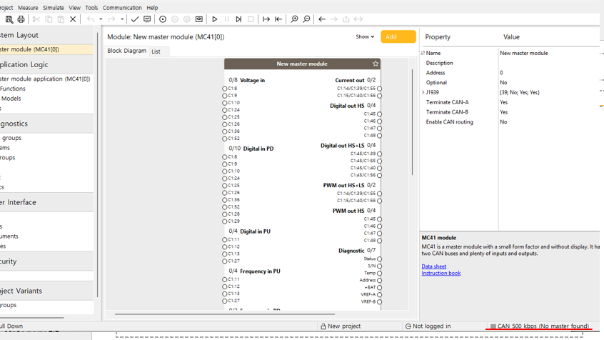

IQANRun could pick up on the speed of CAN in either 250 or 500kbps by the selection window. How about IQANdesign? I could not these any User Interface to shift of CAN communication but automatically fixed up. Please let me get to know how to a change of it? the next on the right bottom status window is put as a screenshot.

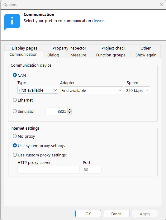

If you go to Tools/Options you can look in the Communication tab to find the CAN speed.
