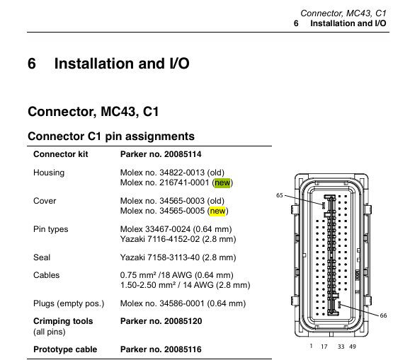

The supplier have decided to change part numbers on all of their harness connectors used in the MX123 connector family due to an improvement in Wire Dress Cover retention. The replacements have no change in form, fit or function.
This will affect following parts that we recommend using for IQAN-_C4_ family and also the IQAN-MD5 family:
Part numbers change:
IQAN-_C4_:
66-P connector 34822-0013 -> 216741-0001
73-P connector 34566-0103 -> 216739-0001
Dress cover       34565-0003 -> 34565-0005
IQAN-MD5:
56-P connector 34576-0703 -> 216742-0001
56-P connector 34576-1903 -> 216742-0007
Dress cover       34575-0003 -> 34575-0005
We will update our documentation to reflect this change.

FYI, the old cover is not compatible with the new connector and there is a significant shortage of all parts. Quite a mess...
Thanks for the heads up about the cover. I didn't think they would do something like that (they couldn't make the old cover work?). I am also in a bind trying to get a few connectors (old or new).
I have found that the old cover will actually work with the new connectors. It does not fit perfectly, but the cam will close and lock. I was able to order some of the 34822-0013 from China off of Alibaba.com. Shipping time is about three weeks, but several vendors claim to have them. I have not received yet. I purchased from:
