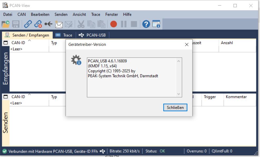

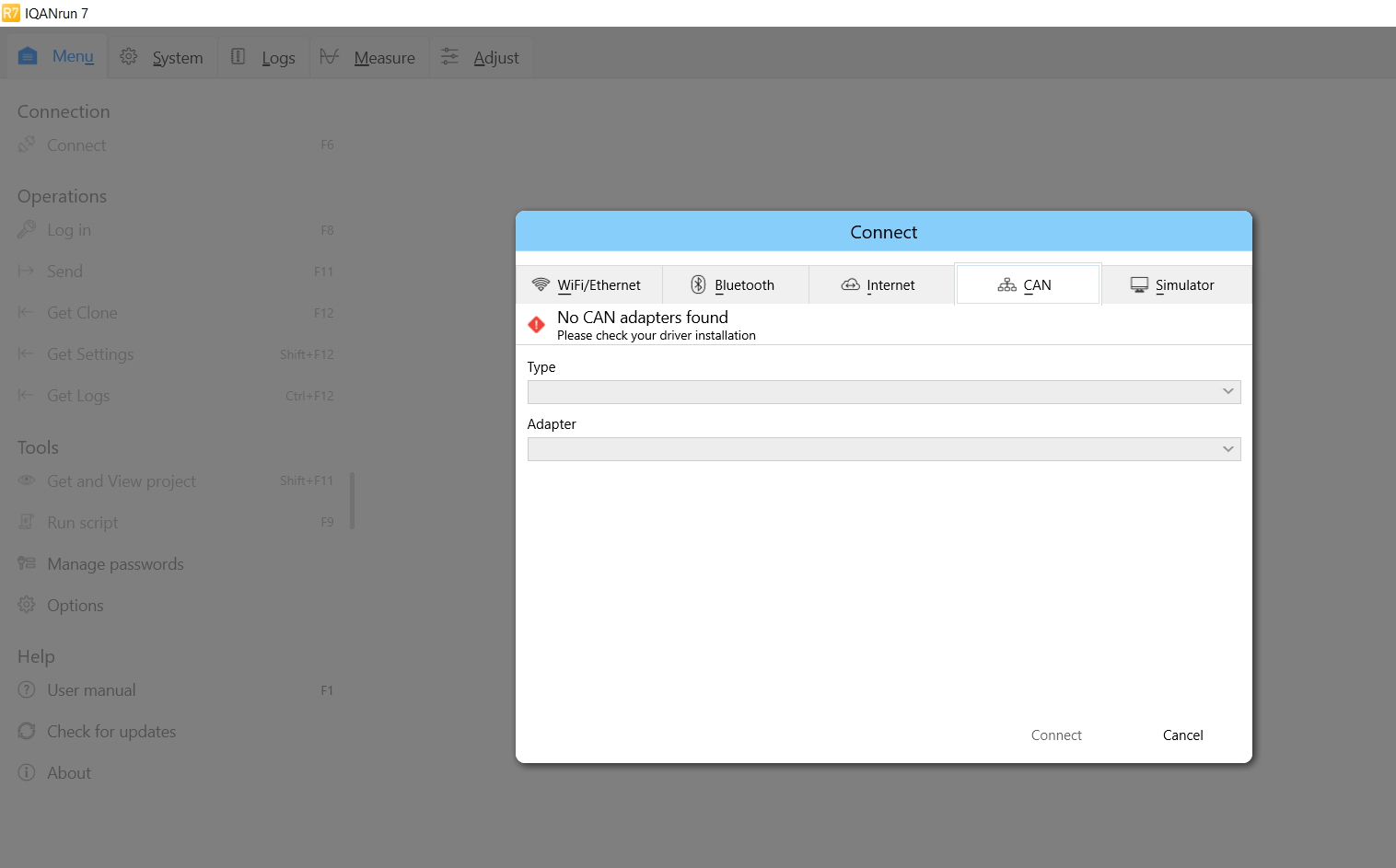

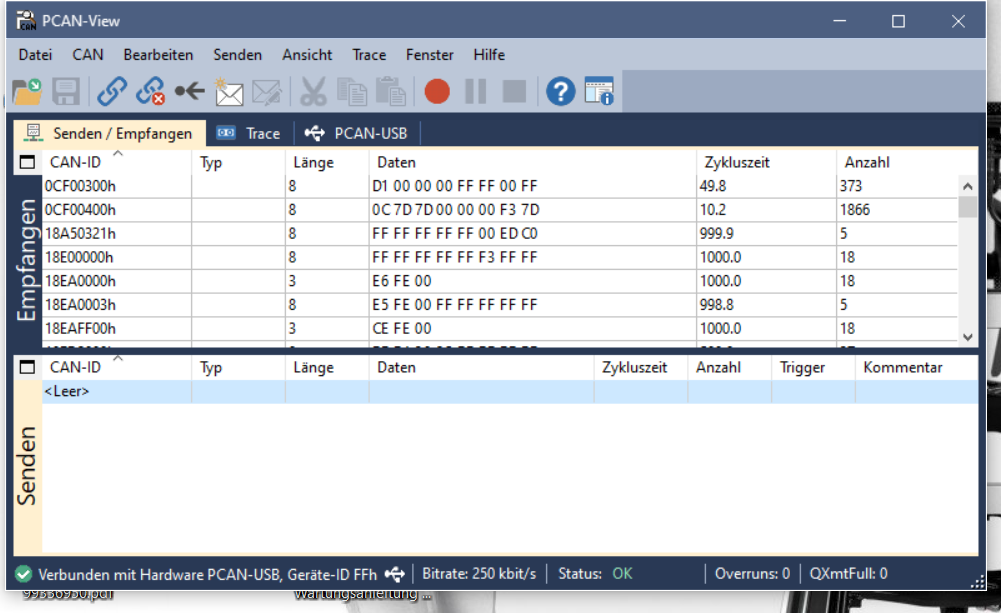

IQAN RUN 7 die Verbindung mit Peak Dongl wird nicht aufgebaut.
Mit PCAN-View sehe ich das Fahrzeug

If it does not show in IQANrun 7 but works in IQANrun 6, then then it is probably that 64-bit drivers aren't installed.
For PEAK specifically, also see the above comment about having to install both the drivers and the API.
Hello Gustav Thank you for your support. The driver with the API was the problem it works fine
