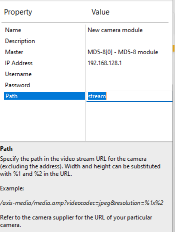

The path property you set in IQANdesign is amended to the IP address to give a full RTSP path.
Image 4871
If you for example have IP address 192.168.128.1, and set the Path to "stream", the resulting path will be this:
RTSP://192.168.128.1:554/stream
A common pitfall to forget to check is the port number, we use 554 which is RTSP standard, but I've come across camera  models that are configured differently.

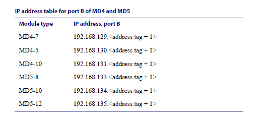

I am confused by the design manual page 97 instructions. The instructions have an IP address other than 192.168.128.xx for static IP connections. I have tried the camera on a MD4-7 and MD5-8 without success. The SC camera for the MD5-8 shows an address of 192.168.133.2 and port 50004 on wireshark. This agrees with the manual. When I try to enter the listed IP address in the program, it gives an invalid IP address error.
Image 4873
The table shows the IP address the IQAN master modules will take on port B.
A camera with a fixed IP address that you connect here should have an IP address in the range 192.168.128.x, this ensures it will not have the same IP address as the IQAN display.
The camera should be configured for subnet 255.255.128.0.
