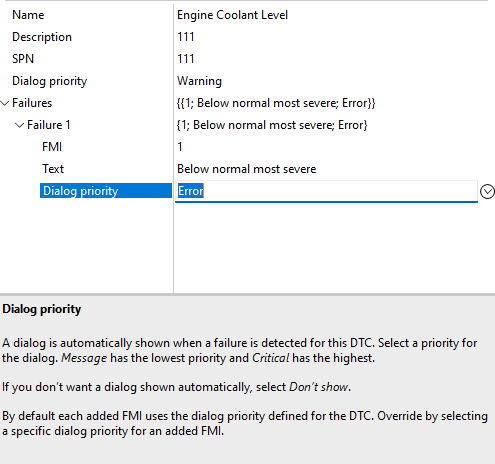

Implemented in IQANdesign 7.05:
50468Different DTC dialog priority for different FMI
New property Dialog priority for each FMI added to a DTC channel.
By default it inherits the dialog priority for the SPN.
Example of how to change dialog priority for a specific DTC
Image 4985
Image 4984
