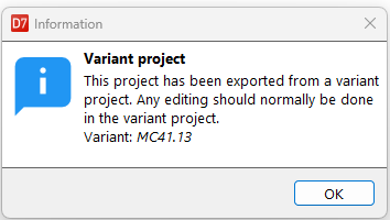

I'm using 7.05.27.10982
However, if the project had variants and the need for variants no longer exists it seems impossible to remove the alerts that the project should be edited in the variant project not the regular one.
So to be clear, all variants and options were removed, and then saved as a regular project.
Upon opening the project this dialog always appears:
Image 5224
So the name appears next to the Add button at the top (though there are no variants)
Have you managed to solve this problem? I have it too.
thanks.
Found the remaining issue with the information about variant remaining in .idvx saved as .idsx/.idax. Will be fixed.
