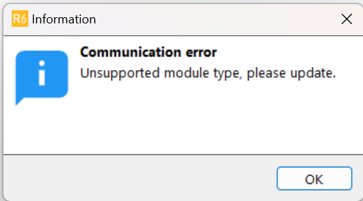

It used to be possible to connect IQANrun 6 to new machines and copy modes but after a recent IQANdesign update it does not work any more.
Image 4963
Can you please fix it so IQAN run 6 can connect to new machines again or add back the copy mode feature to IQAN run 7?
