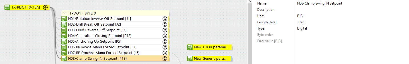

In Fact, the GPIN has an error value equals to 3 when the value type was integer.
Why the error value is not enable when linked to a generic frame in ?
Image 4721
Why the error value is false or true in J1939 parameter IN and numeric in Generic parameter IN ?
Image 4722
Image 4723

Thanks. That the error value remains but is grayed out in IQANdesign when changing GPIN from integer to digital explains it.
In 7.05 IQANdesign will no longer gray out the property, it will be a Boolean, and it will be automatically set to false when changing value type.
