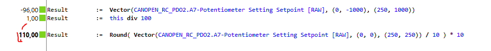

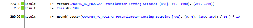

Expected -2 result for (-16.80 div 10) operation;
Expected -1 result for (-13.60 div 10) operation;
With integer division the fractional part is discarded, not rounded.
This is for the result out from the function, the input is rounded.
so 16,8 would be rounded to 17 and so on.
So for (-16.80 div 10) you would expect to see -1.
But as for -13,6 you would want to see -1 also and the 6,15 you would see 0 on also.
Is something else happening in this code that can mess it up?

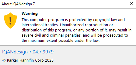

What version of IQAN are you using?

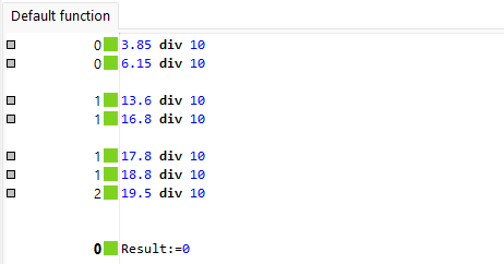

I tested the div functionality myself and got these results.

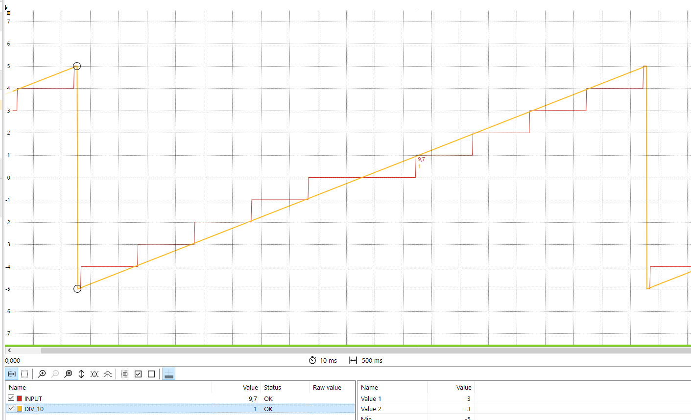

in fact, if input is integer, works normally;
But if input is not integer, as in example, 9.7 div 10 equals to 1, expected 0
Image 4788

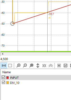

in this example expected -3 when -39.7 / 10 equals to -3.97, then keep entire...
my similar code when i wrote the bug request
Image 4790
incoherent result, perhaps new bug as following
Image 4791
Image 4792
<This> seems be the final result ? not sequenced steps ?
Hello.
Now i see what is going on here.
"This" is actually the final result of the previous cycle.
So this would explain what is going on.
The "this" parameter can not be used in sequences like you are trying.
I would suggest just using an internal parameter in your code instead.
Then you could use sequenced steps like you are trying here.

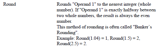

The results in your table is in line with how the IQANdesign user manual describe the Round function:
Image 4807
When the value is exactly halfway between two integer numbers, the result is the even number.
