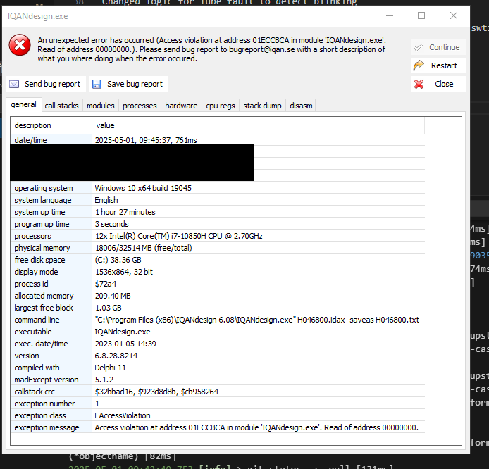

There is a bug which causes the IQANdesign.exe application to crash when using the -saveas & -diff functionality from command line. I have verified this on two machines, the application crash happens (citing access voilation/reading null pointer) both when called from command line, however I am however able to run both commands from inside the gui application. For my purposes I am not able to upgrade to the latest version of IQAN as our entire codebase is running on v6.
IQANdesign version = 6.08.
Best Regards,
Raazi
The report looks like a bug in 6.08 that cause, it is triggered when adding an instance of an external function with translated adjust item.
Solved in IQANdesign 7.00, ref case 58046 in release notes.
