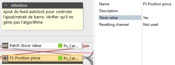

Image 4805
The store value of finite state machine object is not working in a specific way :
- store value is Yes
- function containing the finite state machine can be disable : in my case, it is disable at startup during at least 1500 ms.
But in this specific way, the memorized object works fine !
Image 4804
BAD, I'M UNSATISFIED
I'm very disapointed because I want the "Finite State Machine (FSM)" object to work as a "MR" object when these are disabled at system startup. and actualy, you can’t propose me any solution.
In fact, I have to use an MR to record the FSM value and I have to add a transition for each step in order to set it to the correct value (Identical at when the system is shut down). [not maintainable in case of evolution, and/or difficult when they are many steps]
It doesn’t make sense that disabling an FSM will reset it to default state, when I could use the "reset channel" to reset it when I disable it only if i want, not the MC43.
It is even less understandable why the MR object is not reset in the same situation.

Not a bug
Disabling of an FSM resets it to default state.
This is how it is designed, so it is not a bug.
But documentation should be better, the IQANdesign user manual will be updated to clearly explain this.
