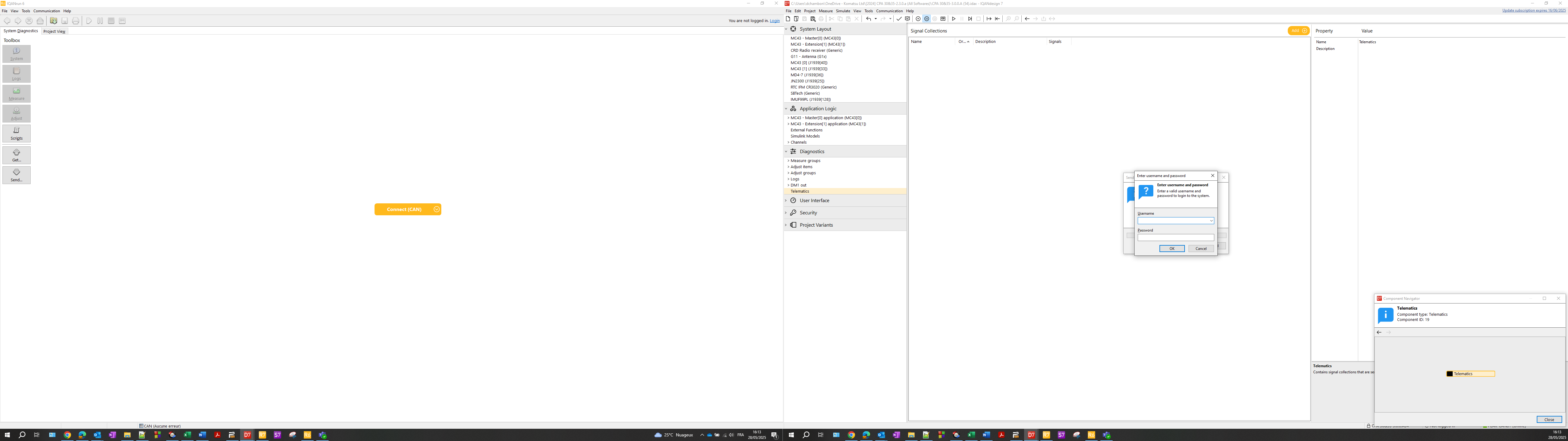

I open a measure with IQANRun 6.0 for study my waves, and do some modifications if necessary in IQANDesign 7.0 as following
Image 4827
The IQANDesign shall be able to disconnect only if IQAN Run is connected in order to download software. not closing my opened measure in IQAN Run.

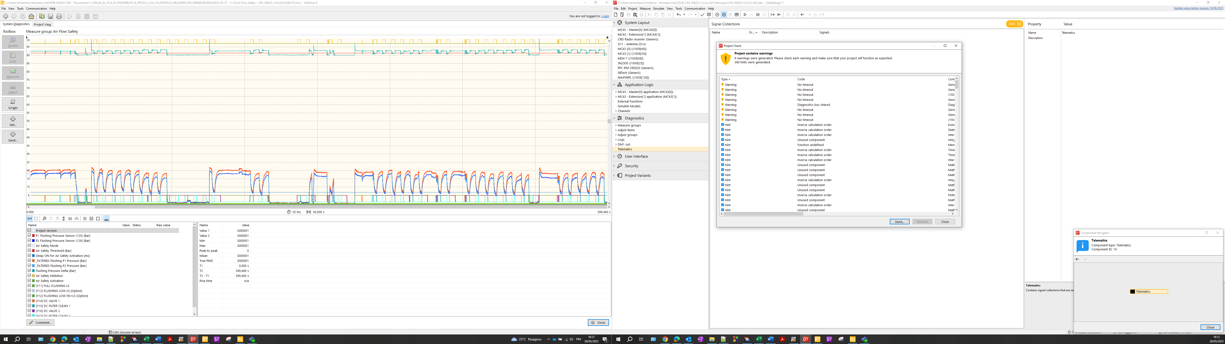

Image 4828
It is very unconfortable to reopen measure again, and redo few operations in order to retrieve my selected signals, etc..
The following steps is closing the measure on IQAN Run6
¤ From IQAN Design 7, click on "disconnect" item from Communication  tab
¤ From IQAN Design 7, click on "login" item from Communication tab
If you have an ongoing connection with IQANrun (for example to measure online) and  connect IQANdesign, IQANrun is disconnected. That is by design, only one session open and switching over automatically without having to disconnect.
But it sounds as if you are saying you weren't connected with IQANrun?
