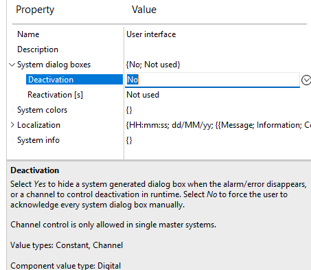

Changing this property in IQAN Design may remove the error after the module connectivity is restored:
Image 4835
