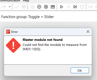

If a system gets switched off or becomes disconnected suddenly (interrupted Bluetooth) during measure in IQAN design, I have noticed that measure still remains active and design wont let you do anything until the measure icon is switched off. Initially took me a while to see what was happening as the comms toolbar (I was attempting to reconnect) was greyed out until the measure was unlatched. See measure icon below still active after disconnect and browsing to a page in the logic.
Weirdly it displays a simulator error after disconnect even though its actual hardware I was connected to:

"master module not found" is an interesting clue.

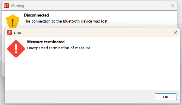

If you are actively measuring (system layout or application), you will see "measure terminated" and "disconnected"
Image 4851
I think the situation might be that you had the measure button active, but was viewing a part of IQANdesign without an anything to measure at, like looking at say display page editor.
Then you won't have the "measure terminated" dialog.
After disconnecting Bluetooth, IQANdesign will revert to have the last used diagnostic interface selected (Simulator, CAN or Ethernet).
