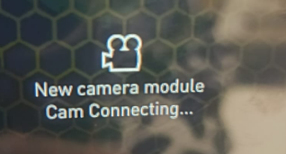

There is information like below but we could not connect the camera. What could be wrong? We are using MD4-7 screen.
Image 4866
Video Cam says not assigned right now, there is a connection but what am I missing?
Are you using Parker SV camera or generic 3rd party camera?
I added it, but it still doesn't communicate. We also connected with DHCB. I connected the camera with video control to show it on the screen.
For an SV camera ...If it's unassigned go to Menu > System > Cameras on the MD4 and assign the camera if it's showing.up to the name of the camera in the program.
I am trying to connect a 3rd party camera. The video is streaming on the network and is used by other devices.
You'll need to provide more information - what camera?  Does it have a static IP address in the 192.168.128.XX domain?  Are you on the correct Ethernet port for the camera (not the programming port)?
Yes, I can set the IP address. I am using the port B Ethernet connection. Using wireshark, and an SV camera I can see the camera is set to IP 192.168.128.4. When I set the IP on the generic camera to 192.168.128.6 It is recognized  by the module in camera setup but does not connect. My problem is I do not understand the cryptic URL instructions in the "path" setup for the generic camera.
