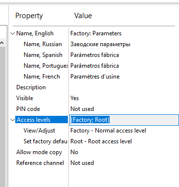

For Reference, the Factory: Parameters Group that Sam is trying to modify is protected by a Factory Password. The group is large and has approximately 92 items in it.
The project has an MC43FS and an MD4. The majority of the parameters exist in the MC43FS.
Group:
Image 4868

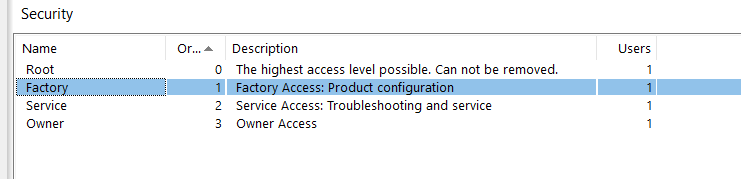

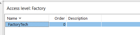

Security:
Image 4869
Image 4870
