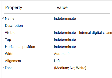

I'm working on creating a display page for an MD4 which dynamically shows and hides items depending on what option is selected. I'm finding that when selecting a few parameters at once, when I go to change what IDC is making them visible, that it reverts back to indeterminate as soon as I select a different item in the properties window.
Image 4872

I mean a different display control. So I select a few display controls that have different values for the visibility property, I start to type the desired new visibility property value and select the one that I want, then click away. When I go back to any of the previously selected visibility properties, they still have the original values rather than the value that I selected when those controls were all selected together.
I think I managed to reproduce, but I needed another step.
Selected multiple display controls and the Visible property, start typing the name of channel to use as Visible and selected it. If I stop here it works. But by using Ctrl+click to add more display control to the selection immediately after, and then try to set the Visible property again, I see the symptom you had.
