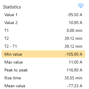

I only manage to see the statistics:
Image 4904

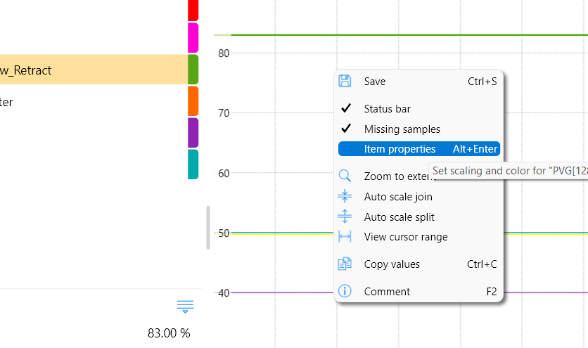

It took me a while to find. You have to select the channel on the left then on the graph right-click and select 'item property'. I know I'm getting old, but not a fan of IQANrun 7.
Image 4905

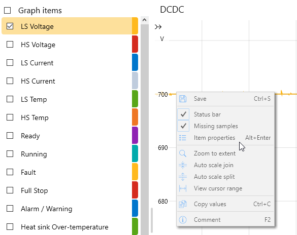

And yes...thats a good clue. It seems to be there! but...I select the channel, then right clic on the graph...although all actions seems to be greyed out:
Image 4907
Any idea why??
This is a known problem, all of the settings are not useable in that version. Will be fixed in 7.05 i've heard. To work around you can go one version back and this will be no issue.
Not sure. I can't duplicate that with an open file or even when actively measuring.
