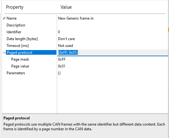

You can use paged protocols with both GFIN and JFIN.
The page mask and page value is up to four bytes, so mask must be somewhere in the first four bytes of the data field.
Image 4958
Not sure if I misunderstood the request.
The only way to know if a message is from engine 1 or engine 2 is to look at the instance value. That is fine unless it is a multipage message. All pages after the first page do not include an instance. I can mask for page, but I dont know which engine the information is coming from. I don't know if there is a solution for this besides putting each engine on separate NMEA2000 busses.
