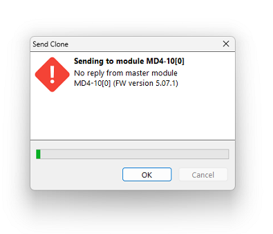

I am trying to assist our client who uses IQAN Run 5 and Elevat CAN bridge to remotely connect to an MD4 in order to get / send clones. When doing testing, we are able to connect via the bridge, however, when we go to get / send clones, when get the following error.
Image 4989
Is there a way to increase the timeout settings within IQAN 5? As the devices that they are trying to connect from via the bridge are communicating over cellular (to my knowledge) and have ping times of over 300/ms to the gateway.

It is much better to connect Ethernet/LAN from the MD4 to your cellular gateway/VPN-device. Skip the CAN bridge.
If you have MC4 or XC-devices the MD4 will send application to them through the diagnostic bus.
Another option is to use G11/G12-module with IQANgo.
