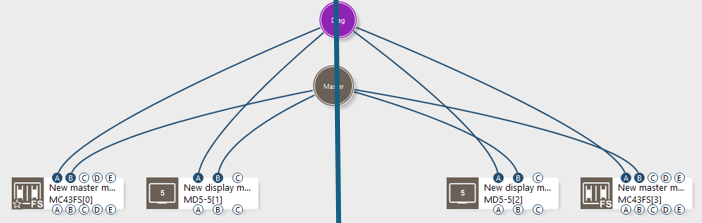

We need a multimaster system that has (1 x MC43 and 1 x MD5) and (1 x MC43 & MD5) that exchange app in / out data when diagnostic and master bus is connected but continue to function with their own program using local IO when the systems are disconnected from each other. Each separate system has 1 x MC43 and 1 x MD5 display for viewing information inside the MC43. See system below showing the disconnection between the two separate systems:
Image 5016
The separate systems need to talk to each other using appin and appout, but still run separate control programs when disconnected.

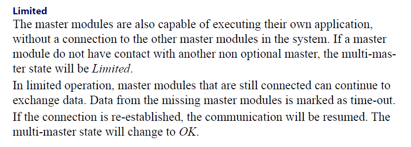

Below is an extract from the IQAN user manual:
Image 5015
In this instance, I make the non headmaster optional in the settings so when the optional modules become disconnected from the headmaster, i get no errors in the headmaster and the headmaster. The headmaster continues to run its own application in a valid system state.
