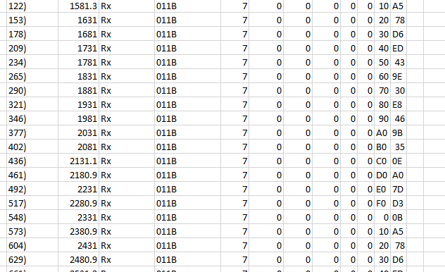

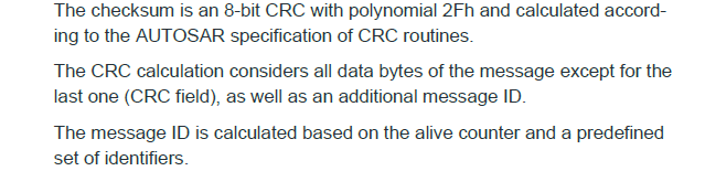

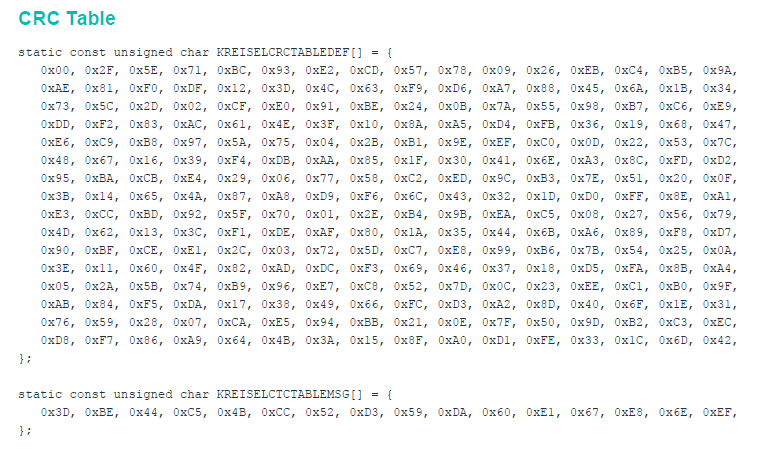

Hello, Im trying to setup a CRC channel to communicate with a Battery system. I can not get the right setup to match their values for the Autosar CRC
Image 5023
Image 5024
IM not familiar with the CRC channel but when I set it to 0x2F with a 0xff seed this is what i get:
Image 5025
