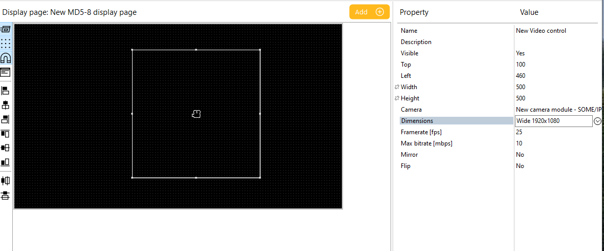

We can already set the width and height and resolution of the camera,  but there is no way to tell the system what part of the camera feed we want to see.
Image 5070

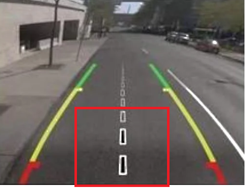

Like I want to zoom to just these area of the camera.
Image 5071
