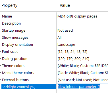

We use adjustable function parameters to control the back light intensity (day /night) - and then send them across using  AppOut and AppIn to control the Back light intensity for the other modules.
There is a property in the MD4 display pages that you can set backlight control using a channel. Like Carlyle said you can use appout and appin to send this channel to your other master.
Image 5086
Thanks guys, I'm aware of the backlight control channel and the ability to use integer parameters to set the backlight. I was just wondering if there was a way to avoid doing it this way since my end users are use to using the system menu to set their brightness.
okay personally I dont know how to do that. Good luck!
