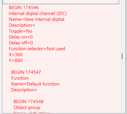

Sometimes I find myself collaborating on a project with an engineer who is at a different location and have to test their program changes for them. It would be much easier to find a given channel or object that they are referring to if they could just give me an object number (which you can only find when doing a compare) for me to stick into the find window.
Can we get an item in the status bar next to the project name and version, which shows the number that would normally show up next to BEGIN or END in the project compare window?
Image 5110
For compare some projects, i export from IQANDesign to TXT Files.
With an external comparison tool, I can compare easily.
You completely missed the point of my post. I'm asking for a way to give someone a number they can use to jump to a specific channel. It has nothing to do with comparing projects aside from that being the only place I can find these object nubmers.

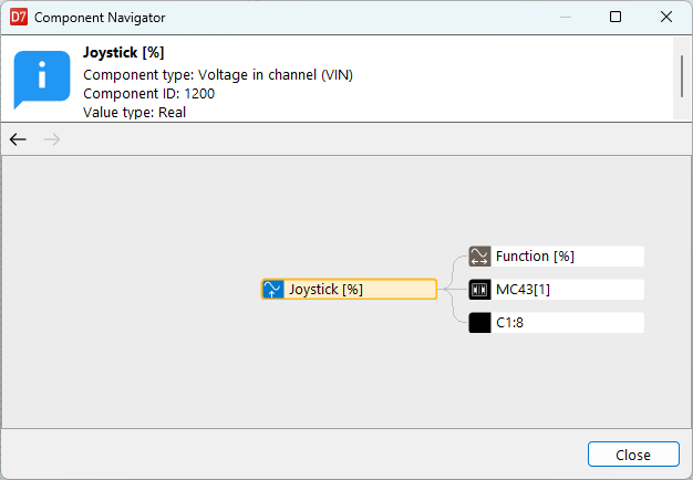

The number you see in the text representation is the Component ID.
You can view this by bringing up the Component Navigator (Ctrl-J)
Image 5112
Knowing this is quite a game changer when it comes to collaboration on a program. Is there any chance we can have this shown in the status bar when you select a channel?
Even then not easy to find, I think, you have to be on the object to see the component ID.
Are the object ID listed somewhere ?
Would be nice if you can navigate from a listed object ID directly to the object, like you can from 'Channels' with 'Component Navigator' on
