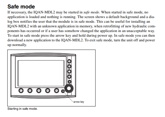

From this error screen on the MDL2, I can tell this must be running version 2.x
If the module is updated to version 3.x, you would have a more detailed error code, including SW version.
When it is in this state, it does not matter which communication interface you connect to.
Use the button combination for bypass application ("safe mode" in instruction book) to start up without application.
Image 5166
That should help you get past this state.
If you have a 3.x version of this application, try updating to see if that solves the problem.
