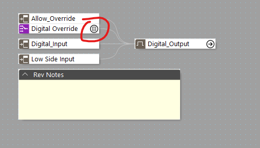

Insert an external function (everything is correct)

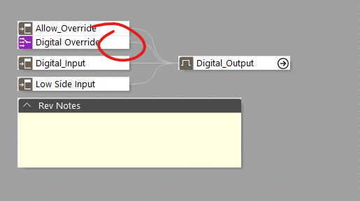

I copy and paste it, to and another one.  And the ability to now adjust this item is removed, and I cant not figure out any way to fix this.   Other then deleting the whole group and adding it manually back.

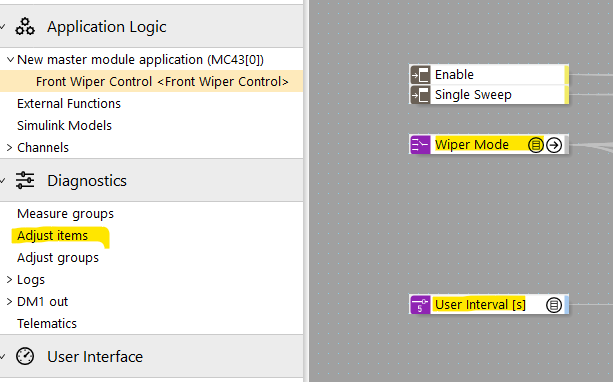

All adjustable parameters that you have in the external function are located under "Adjust items" in the project tree. See attached pictures.

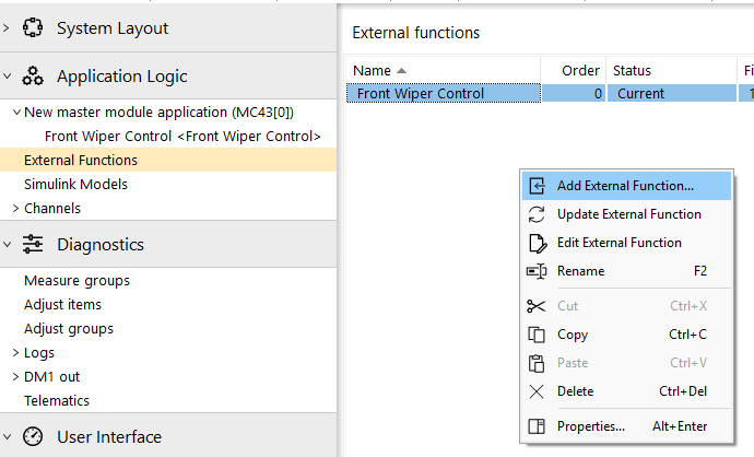

If you copy (Ctrl-C) and then paste (Ctrl-V) your external function then the adjustable parameters will not be adjustable anymore. You will then have to assign them to an adjust group manually. But I would advice against copying/pasting external functions and rather add an external function to your project like this in order to keep the parameters adjustable:

Is it the instance of the external function you are copying?
I noticed that when copying the instance, adjust items do not get copied.
But to add multiple instances of an external, you could use the Add menu.
