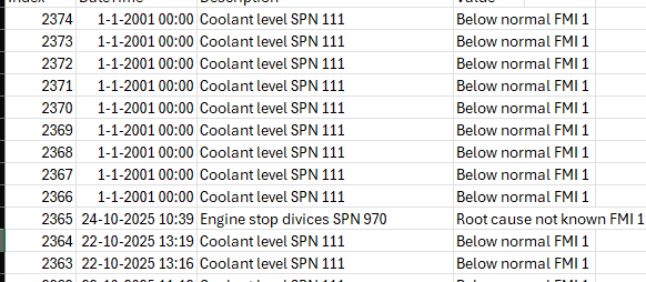

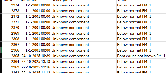

I'm encountering a problem with the downloding of the log files in IQAN run 7.
when I select all log then it shows the component, but after I selected to get all records it will not show the component anymore, and it will only show : "Unknown component"
Before:
Image 5204
After:
Image 5205

A situation where I would expect to see "unknown component" in an event log would be an application update, where the component that had a log entry had been removed from the application. That does not seem to match what you describe though.
What type of log item is it? At first glance I thought it was a DM1 log item, but it appears to be something else.
It looks like it might be a value log item logging a DTC channel?
What version are you running in the master module? E.g., 7.05.27
What version of IQANrun are you using?  E.g., 7.05.32
