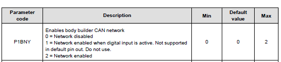

I'm pretty new to J1939 communication and need a little guidance how to send "codes" to a truck. To read on bus traffic (parameter in/frame in) i have learned the hard way, but now i need to send also. For example how do i send this code? Which "boxes" should i use? If someone explains this, then i think i will figure out the rest on my own :)
Image 5225
As far as I know, these parameter(s) can be set by authorized (Volvo) technician.
Message below can be send: See bodybuilder can gateway manual
