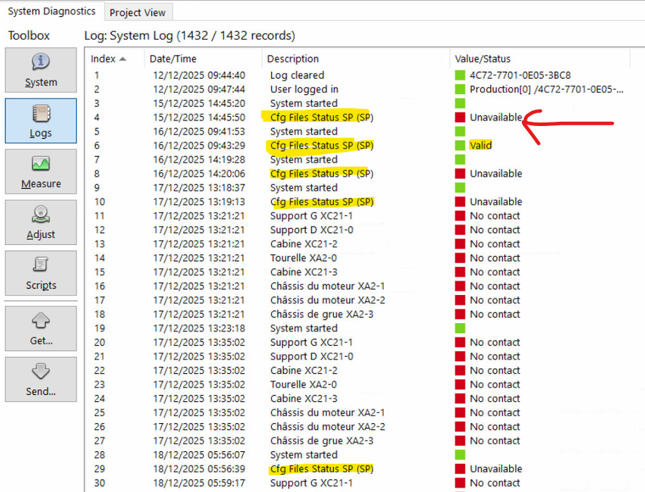

what does description "Cfg Files Status SP" Status  "unaivailable" means  in System Log (RUN 6)?
We have plenty of errors of No contact at that period when the machine was still at the manufacture, then all those no contact pop ups at our workshop when the machine was delivered
I wonder if that System Parameter (SP) have had an incidence ?
Image 5230
we found a CanBus wiring issue on Can A after the display that explain all the No contact alarm
I get a short explanation there about the Cfg file:
The Cfg Files Status is a message from telematics to display the configuration. There is a delay due to the frequency of messages being sent between the telematics module and the machine which would have generated that system log item.
so all good  ;)
