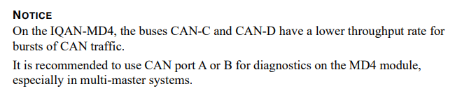

Currently have come to the conclusion that on bootup we get CAN error frames on chassis with 500k baud rate that are currently connected via CAN C, D of the MD4-7. How is the boot up and initialization take place for the baud rate? I have come to believe that the initialization isn't taking place correctly and is knocking out the 500k intermittently on startup.

from the MD4 manual, maybe a timer that blocks inputs/outputs for the initial 2-3 cycles may be needed?
What software version are you using?
I assume it is newer than 4.03? See Release notes - IQANdesign 4 "Improve start-up sequence of CAN"
The latest update on CAN speed is in 7.05 with the autobaud feature.
