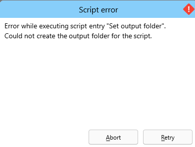

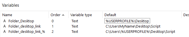

I'm looking to make a script to help our customer to make some adjsutement,backup ... on there machine.
Because they are not happy with computer, I want to simplify them lot of thing.
For exemple, I try to create an output folder on the Desktop to find it easily.
If I put my computer user profil it works
C:\Users\MyName\Desktop\Script
But the tehcnicien doesn't have the same name than me,
and if I put a link with a Windows generic link like this, it doesn't work :
C:\Users\%USERPROFILE%\Desktop\Script...
Image 5240
So, How can I create a folder on the desktop of any computer that will run the script ?
Image 5239
