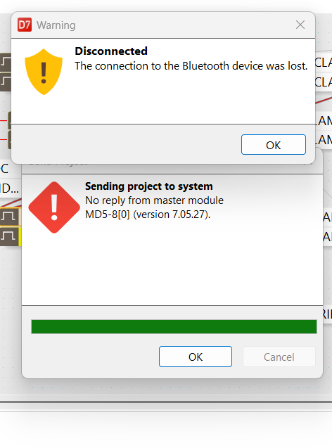

Whenever I connect via Bluetooth via laptop and try to measure it disconnects.
I can make modifications to the program but trying to measure is impossible.

I am having the same problem with 2 different G12 modules on two totally different machines when connecting my computer via bluetooth. I experienced the same problem connecting via the Parker app for remote connection also.

When connected to computer via Bluetooth, the error message is  "D7 warning: Disconnected The connection to the Bluetooth device was lost." it takes about 30 seconds to lose the connection.
In Connect Remote, Using IQANgo via a cellular device, the error message is "D7 Warning: Disconnected, You have been disconnected from the remote system".
In both cases after selecting OKAY the Communication drop down is greyed out except for the Disconnect option. Selecting it does nothing. I have to restart IQAN design 7.05 to connect again.
