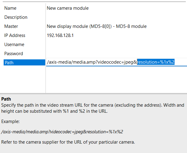

If the camera supports it, you could include size in the RTSP path, as in this example:
Image 5318
I tried that, and it did not work, unfortunately.
