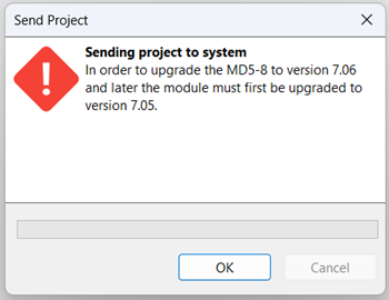

Image 5294
Message when attempting to send 7.06 to  MD5 with version 7.02-7.04.

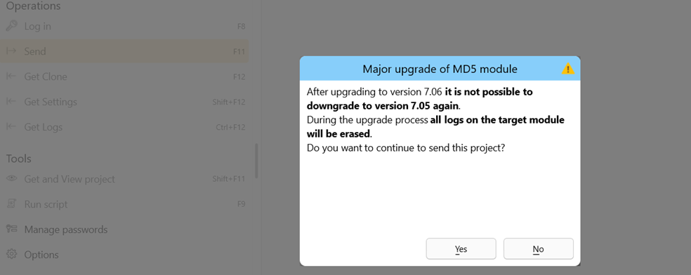

Image 5293
Message about major upgrade of MD5 module , before sending 7.06

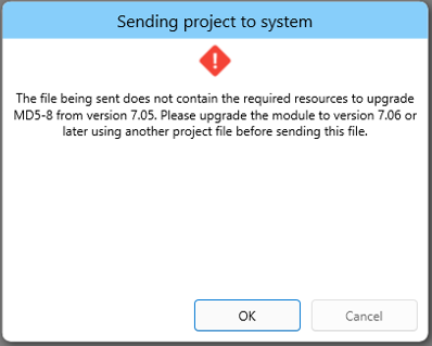

Image 5295
Message when trying to use clone to upgrade to 7.06
