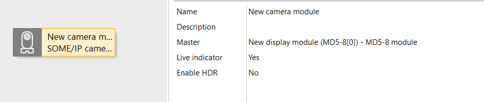

This is expected. In IQANdesign you set one display as the master for the camera.
Image 5317
The functionality for SOME/IP camera module in IQANdesign assumes it gets its IP from the IQAN display acting as DHCP server. There is no functionality implemented for coordinating this between multiple IQAN displays.
