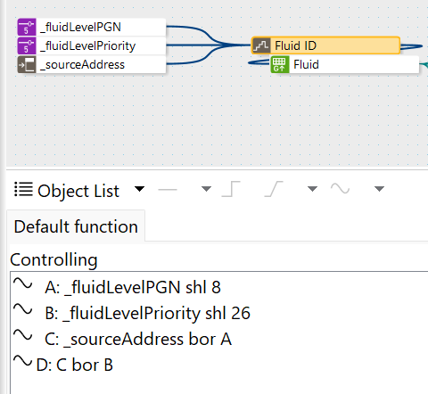

A GPIN can accept an identifier as an input. You need to build it with the priority, PGN and source address.
Image 5314
Make sense. I will do that. Thanks for the suggestion!
