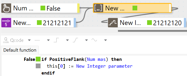

If you store an integer composed of 8 or more digits, in many cases the stored value does not match the expected reference value. The discrepancy typically occurs in the least significant digits, which may be incorrectly stored or retrieved. However, the issue does not appear when the least significant digit is 0, in which case the value is handled correctly.

Value type of the ARC array channel is Real.
The 32-bit real value only gives you seven significant digits.
