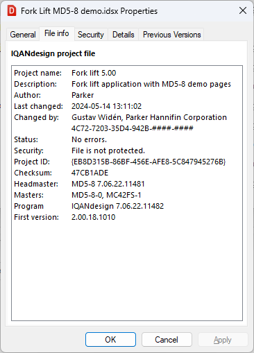

The IQANdesignLauncher.exe is opening project files in the major versions they were saved in, 5.x, 6.x or 7.x.
To find out the exact IQANdesign version a file is saved in, you can right-click on it in Windows explorer, select Properties and File info.
