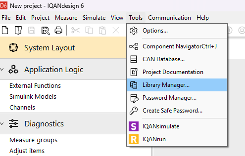

Go to Tools -> Library Manager
Image 5323

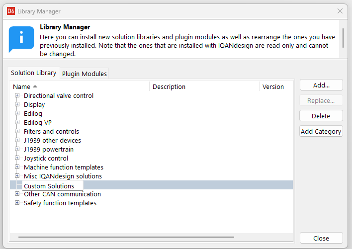

Click "Add Category" and name your category. In this case "Custom Solutions".
Image 5324

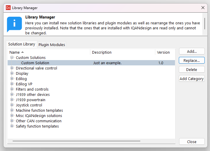

Click "Add..." and select the stripped project file you created earlier. Then it should look something like this:
Image 5326

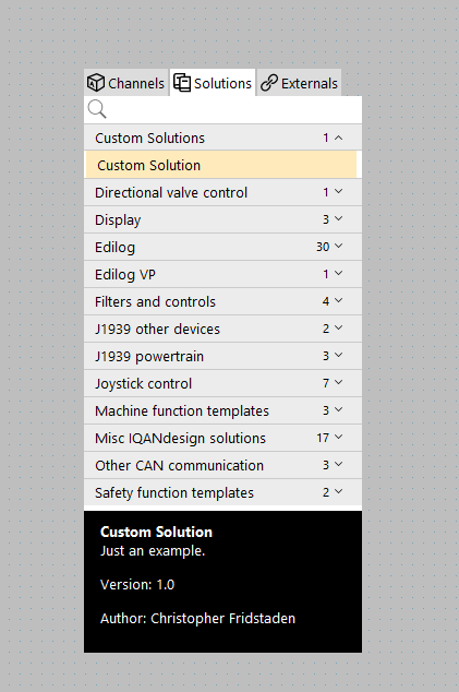

When you want to add your solution to another project you add it like any other channel. You will find your solution under the tab "Solutions". Like this:
Image 5327
