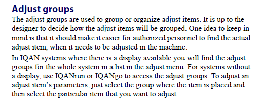

I don't believe so, according to the IQAN design manual, adjust groups can be accessed using the display, IQAN Run or IQANGo:
Image 5341
The intention is to use IQAN Design to design the software and test using simulate, IQAN Run to upload software and make adjustments to system parameters (through adjust groups).

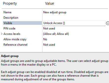

If you logged in as a user using IQAN Run on a laptop to effectively 'unlock' the adjust menu, it can only be used on the device thats unlocked the adjust menu, it then locks the access using the screen if fitted (only one device is allowed access to the adjust menu at any one time). I think the way around it would be allow adjustment of parameters using a IDC driven by internal user tag, then use a on screen button that becomes visible to open the adjust parameter / group once a user has logged in....i may be wrong though and may need simulating to ensure it works ok:
Image 5342
Image 5343
That does give the adjust menu behavior that I am looking for, but not the protection of sending those settings to another machine when sending a clone.
We do have some custom machines, so using develop to send the initial program and for further development is a regular thing here.
