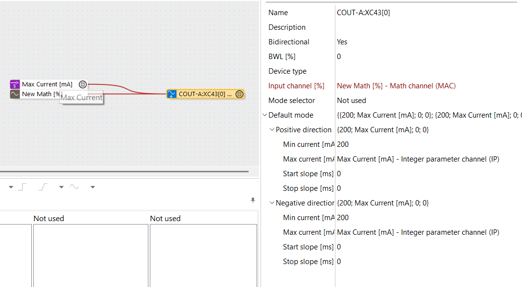

In IQANrun 7, Current Output adjustments like Max Current don't get greyed out like they did in IQANrun 6 when you have a separate parameter controlling them. For example, if I reference an integer parameter channel for setting the max currents, as shown in the example program below:

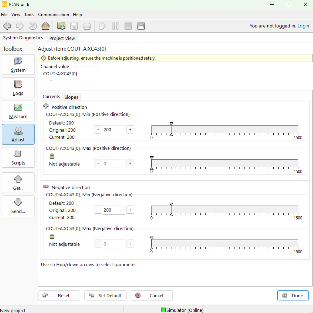

This is what it looks like in IQANrun6 when I go into the current output adjustment. The max current adjustments are nicely greyed out to indicate that I cannot adjust them here:

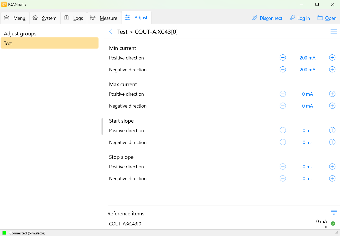

This is what it looks like in IQANrun 7:
Image 5354
In IQANrun7 it actually lets me make adjustments to the Max currents in this current output adjust page, so it appears like you have changed something, but when you leave the adjust groups and come back the max currents go back to the value of the integer parameter which is controlling them. This creates a lot of confusion.
It is a good idea to have the option to adjust those disabled like in previous version.
