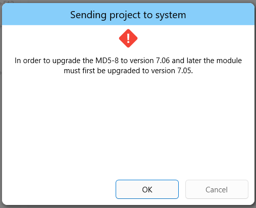

I recently ran into a scenario where I could not update the firmware on a module because my project file was IQAN 7.06 and the module was 7.04. The Module needed to be updated to 7.05 before it could be updated to 7.06.
Image 5357
This has never been an issue for me in the past. Usually the latest firmware would always load without having to load the intermediate firmwares. I simply created a blank project with the masters in the system at 7.05 and loaded it to 7.05, then loaded the project to 7.06. However this problem becomes much more difficult when issuing program changes to the field. I never released software to the field with 7.05, so the service technicians won't be able to update a system in this scenario.

I usually do the same as you, create a blank project with nothing inside, no inputs, outputs or logic etc just a module with the correct address. This will send the firmware and get it updated the the required 7.05. Then its ready for the 7.06 application.
Best bet is to take your 7.04 application, open in 7.05 and save it as an 'intermediate' update, then load in the final 7.06 application file. Get the technicians to load in the intermediate update first then the final 7.06 file using IQAN Run. It means 2 separate updates which consumes a bit of time.

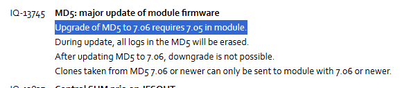

Fortunately I believe this only applies to the MD5 which we are not widely using yet.
Image 5359
I likely glossed over this in the 7.06 release notes since these displays are not even in prototyping phase for us yet.

The 7.06 update is special and need to have the 7.05 loaded for it to work.
Do also note that you can not use a clone file to update from 7.05 to 7.06 on MD5.
The project file contains a intermediate part that gets downloaded, this is not included in the clone file.
The units that are produce now have the secure boot firmware loaded from factory.
The MD5 started from week 24 and the MC4x started from week 25.
My understanding is that this is a specific problem to the MD5 based on the release notes.
