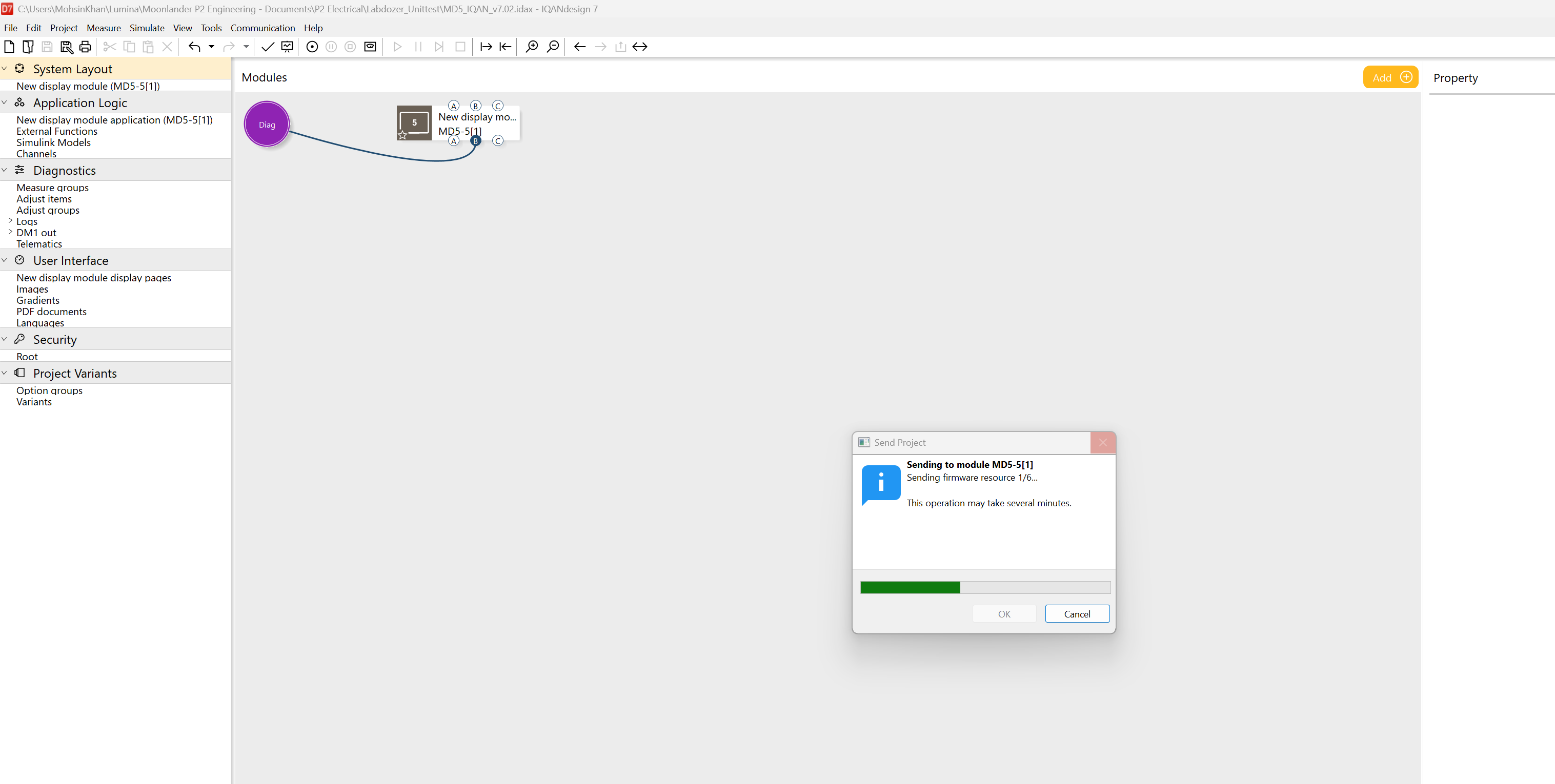

When flashing MD5-5 or MD5-10 displays using IQANdesign it remains stuck on 'Sending firmware resource 1/6...'
I have tried IQANdesign versions 7.02, 7.03, 7.05, & 7.06.
Any ideas on what the issue is and how to resolve?

What CAN to USB adapter are you using? We've had past issues with our Kvaser Adapters taking upwards of 24 hours to push the initial firmware. Have you tried pushing a program with IQANRun? You may need to Assign the Display to ID 0, every program needs a headmaster assigned. Also If you are pushing a new version of 7 that is a different version than what is currently on the display, it takes well over an hour on the initial push.
Tried both Kvaser and PEAK adapters, display ID = 0 and current firmware version is 7.02 on the display.
Made another attempt using a PEAK adapter, IQANdesign version 7.02 to flash just the MD5-5 display, waited over an hour and no success. On the display it shows 'Receiving baseline...' and progress upto 14 before it turns off (it takes around 20 minutes), did not cancel the flash and kept it going for another hour.
