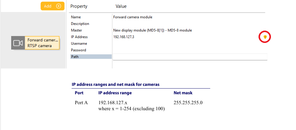

I try to define a static IP address to RTSP camera which is matching requirement on port A in IQANdesign manual but it is a warning symbol about invalid camera URL.

This should only be a bug in the IQANdesign software showing the "invalid camera URL".
The application does not give any errors and is possible to download to MD5.
