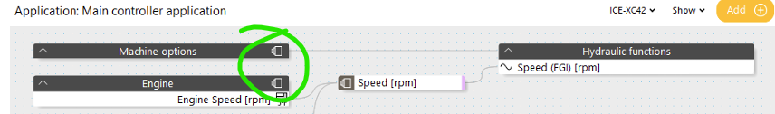

How are function groups configured to be controlled by variant options?
Image 5427
You drag and drop them to the option groups you want them included in the "Project Variants" section.
You get an example of project variants when you install IQANdesign.
You can find it in \Documents\IQAN Files\Examples\Fork lift\Fork Lift MD5-8 variant project.idpx.
