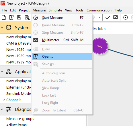

Cant really change the statistic settings in IQANrun, but you can open measure file in IQANdesign.
You can find it under the measure tab but you do need to have the application for the measure file open when doing this.
Image 5441
