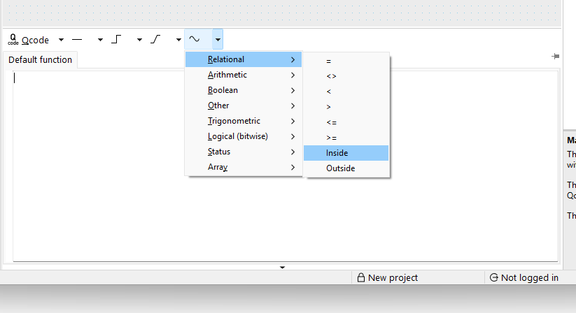

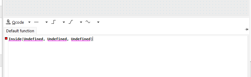

For the syntax for specific functions you can use the drop down at the top of the window to add the desired function.
That will give you the syntax for that function where you only need to replace the values.

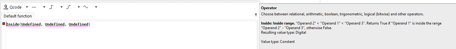

at right view, you can read the description of function "Inside" here
