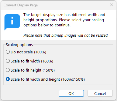

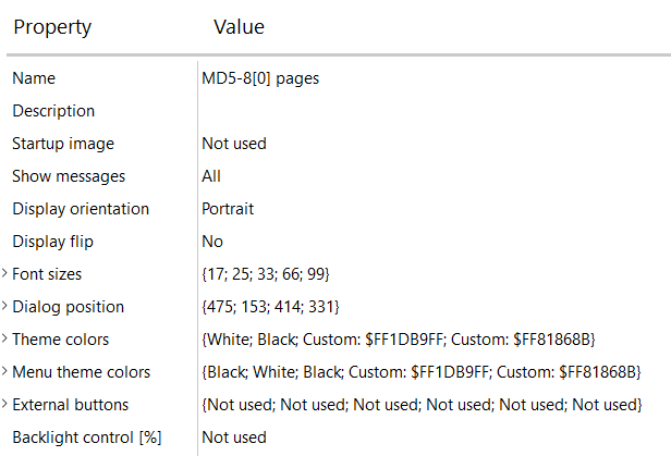

Hi all, converting portrait pages does not seem to work properly. Utility treats it like my destination screen is horizontally mounted which is not (see first picture). Scaling only applies to horizontal proportions (see second picture). Height should be 1280/800*100 = 160% and width 720/480*100 = 150% ? What am I missing here ?

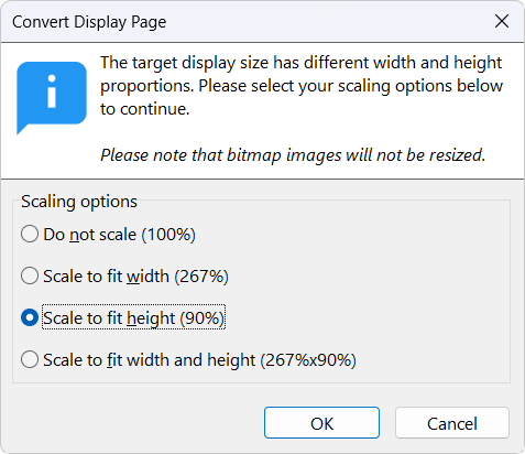

What version are you using?
I just tested in 7.06.21 and i get the correct values.
Image 5503
I am using 7.06.22, re-tested this morning.
Image 5505
Image 5504
Now i see what is wrong.
There seems to be a bug when using portrait on the display page you are moving.
It seems always try to convert to landscape on the display page you are moving it to.
We will fix this in next release.
